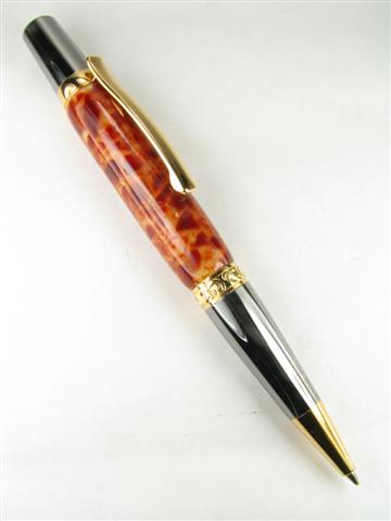

This is an Elegant Beauty in Cinnabar Corian®. It's amazing!

yeah that cinnabar doesn't look like the tiny bit that i have!

Where did you find that gorgeous Cinnabar at?
Hi Rob; I really have no idea where it specifically came from. In a trade from someone I can only assume.
I have a few chunks of what I think is Cinnabar, but in the large piece, and until it is turned and polished, I can't say if that's it or not.
