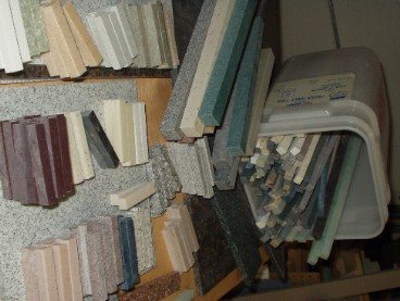

<b>Image Insert:</b><br />
<br /> 32.35&nbsp;KB
All,
I have some of the corian laminates that Jennifer mentioned in the first post. I will post a picture of them later today and will proably trade some away. I'm looking mostly for acrylics or BB blanks.
