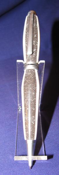

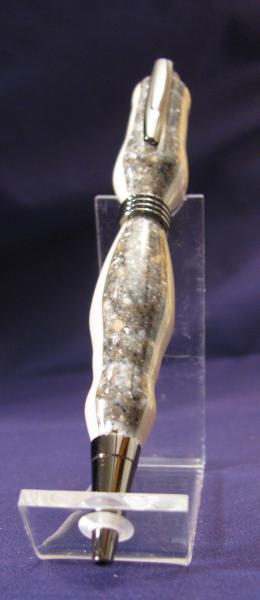

Just glue, drill and go for it! Nuthin ta lose but time.

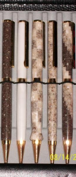

I agree with with solid light colors showing seams. The rest glue up pretty nice. I made these early on in my pen making days.
