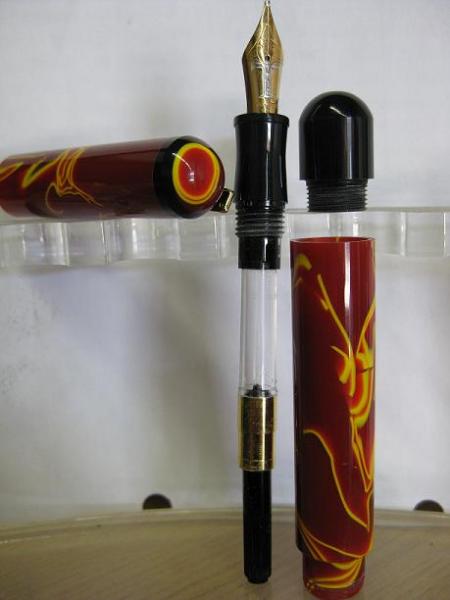

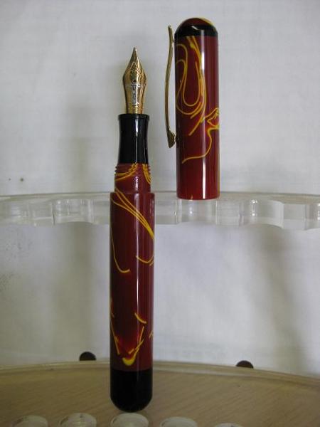

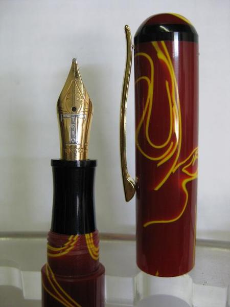

I really liked this plastic and I had a really nice Trio nib so here is a perfect match.
I really like how the top ended up.
Hope you all like.

Really nice.
I really like that blank. I don't know enough about the nib but I am sure it must be special...
Can you give some detail on the cap finial? From the side view it looks almost like it is a different material (all black) except that I can see just a bit of the same yellow color showing. The end view is not at all what I was expecting from the side view.
Looks cool, but I cannot figure out what you did.
VERY interesting!!
NICE pen, and even though I know what the material looks like, I can't figure out your pattern at the end. I LIKE it, but have no idea HOW it turned out that way!!
Certainly a good looking, potentially expensive pen!!!
GREAT work!~
I was not sure if I liked this style of Stewart blank when I first saw it, but I really like what you did with this pen. Great Job.
Keith "mrburls"
Really nice.
I am glad you all like this pen. I was not to sure of the color in blank format but I really liked the end result.
Thanks again
The final was a 3/4 by 3/4 square of black and I glued a 3/4 by 3/4 square of the body material on top of that. Then I made threads on the black leaving a small bit at full size and then taking off enough of the body color till I got a design I liked.
Hope this helps
