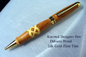

Here is a nice example of what I think of as a double-cross by Robert Krauer out of Maryland.

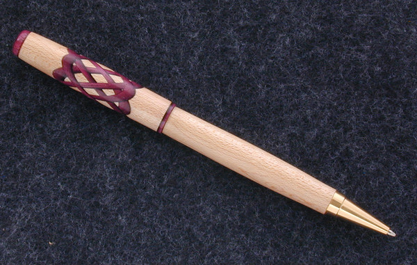

And here is what I think of as a Celtic knot done by Laurie Sullivan. One of the segments wasn't cut quite right so one ring doesn't line up exactly; but I think you can get the idea of the difference between two rings and four.

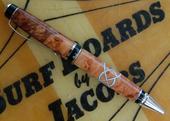

And here is another Celtic knot by Jeremy Freeman(armyturner) out of Oil Trough, Arizona.

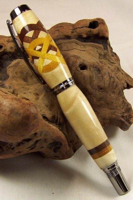

And to add a little more to the confusion, here is another design by Jeremy Freeman that he calls a Double Celtic pen.
Randy, I would have said that both Laurie's and Robert's pens have four cuts ( rings ) And therefore both double crosses
I also would have thought that a Double cross and a Celtic Knot were the same thing. One with just two rings, I would just call a cross - (but not to be confused with the Christian Cross, as done by Eagle and others)
Recently someone did a double cross 'twice' on the same blank. The second Double cross overlapped the first. I don't know how to link the pic.
