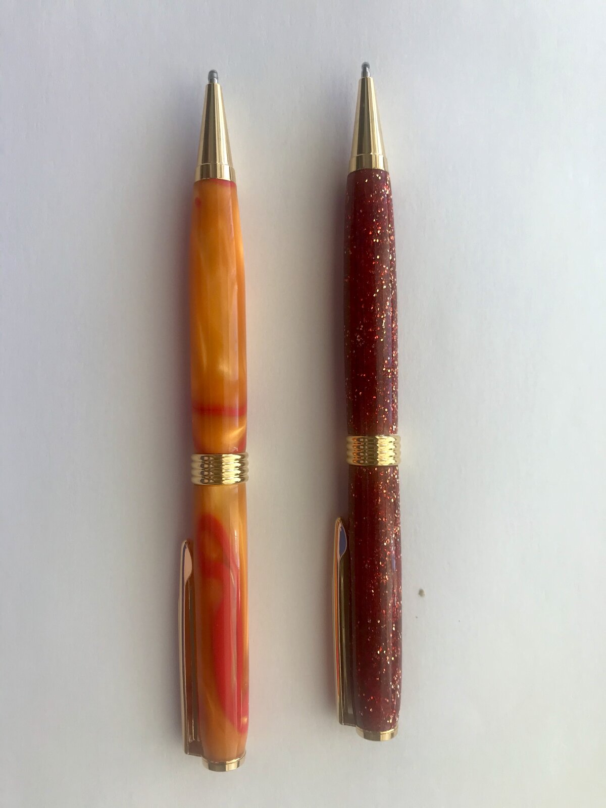

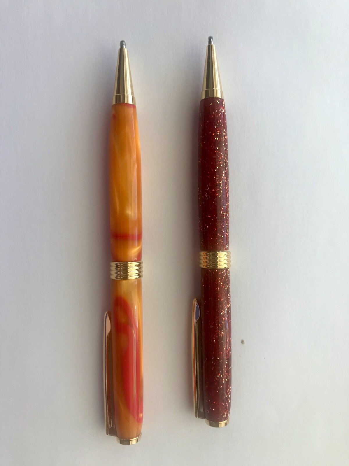

here are a couple of recent examples. The glitzy one is for a friend's daughter who is a dancer, and I thought the blank to be suitable
