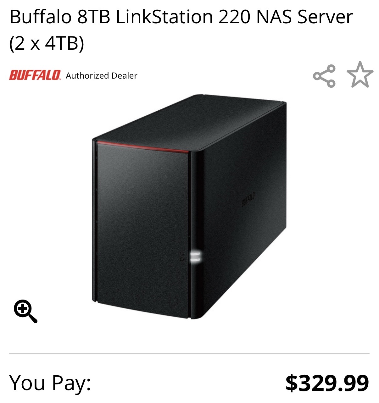

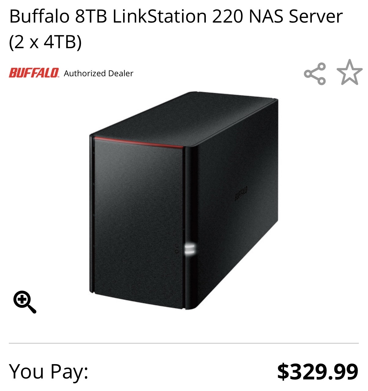

Here is a very different idea. We have fast 1,000 mbps internet from Race. I like to know my data is protected LOCALLY not in the cloud.
I moved all of my data to this NAS drive with RAID. My four computers all find the data in one place and save all data to the NAS. My shop is more than 100 feet away yet loads my 3D file or laser file loads very quickly using WiFi. My wife and I have had to work quite a bit before the NAS to not edit files in separate pcs and get them out of synch. No more
The RAID means basically that every file is on two drives within the NAS. We alter one drive's file and that change is automatically mirrored to the other drive. In case of a crash the remaining drive is functional and the defective drive can be installed and the NAS will re-establish two working copies. It is hot swap able.
I worked to keep a research lab with 50 people using pcs and Macs running. Flash drives died all the time. We came up with a yearly exchange of old to new flash drives after transferring the data just in case. Be careful with flash drives especially off brand ones.
I have this 8 TB NAS. It is perfect. We have 1-2 TB of data.
