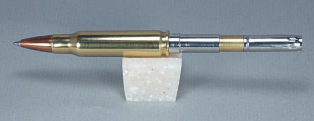

I haven't seen that coupling but what I will do is for 308 shells I drill and tap the primer end for a sierra transmission, the cartridge length with the bullet tip is the perfect length for the parker refill.
For 30-06 I can go one of two ways. Using a sierra transmission I cut off the threaded end and the larger section drill the cartridge for a tight fit slide the chrome section in until I have .36" sticking out and solder it there. You can also use a cigar transmission, if you place the center coupling into the end of the cartridge it is the perfect length for the parker refill. Here I grind off the center ring insert it to the correct depth and solder it in place.

It may be the bullet I am using hornady 30 cal 150 gr FMJ-BT, I may be seating the bullet a little farther than normal but here is a photo of one of my 308 cartridges with the sierra transmission.
Here is a link to the writeup I did on it. This way calls for some step drilling but I will be working to change that in future pens.
http://content.penturners.org/articles/2010/sierratransmission308.pdf

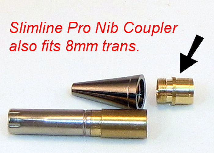

What is their thread size? Could the 10mm tenon be turned down to 8mm?
Technically yes, the 8mm tubes are .289 and the cigar coupler hole is .238 leaving.050 divided in half for wall thickness. However the cigar transimision is different than the 8mm trnas mission. the lower brass is larger in diameter although the upper twist part is the same. This would allow you to use the cigar upper cap/finial if you used the cigar 10mm tubes for the upper blank.
edited in. the cigar coupler also has a large shoulder the center band covers. Depending on your design you might want to trim off the shoulder as well.
Yes. That's exactly what I did for this pen. The coupler and the transmission (inside the pen body) are from a cigar pen kit. I turned the coupler down to fit an 8mm tube. I turned a little bit off the transmission as well, so its body matched the tube OD. That way, the entire mechanism slid in through the 308 case mouth for assembly. The bullet, tube, and coupler unscrew from the transmission to change the refill.

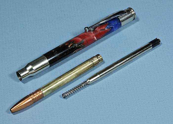

I appreciate the information on turning down the 10mm. I have ordered a few of them from Ww and will give it a try. By way of comparison and general information I posted this a little while ago for a guy on SMC's Turners forum. This is the set up in my recent posting here for a 308 bullet pen. Works very similar to your photo but uses the standard 8mm coupler from a SL-Pro as noted earlier.IMG_1669.jpg
He is a bowl turner and was wondering how the insides worked.

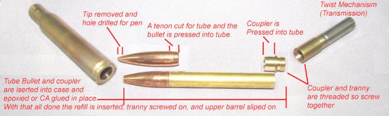

I just used parts I had available. The slimline pro coupler and transmission would have been more convenient. I'll have to try that in the future - thanks.
One thing to note: as modified, there is no "positive stop" for the transmission. That is, it is possible for a heavy-handed user to push the bullet into the case mouth. On a cigar kit, the center trim ring normally provides this stop, but it has been turned away.
I had originally planned for the transmission to bottom out against the upper 8mm tube, but later cut a very shallow tenon on the bullet. The bullet now forms a positive stop against the case mouth.
