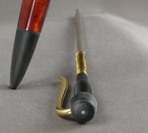

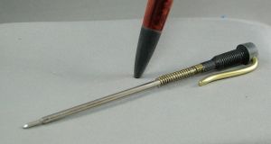

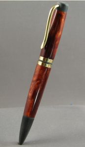

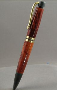

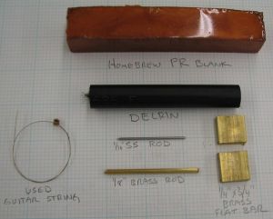

Here's some photos of my PMG submission pen. It's TOTALLY kitless, except for the refill. I even made the spring from one of my used guitar strings. The body is a homebrew PR, the black parts are Delrin and the rest is brass, with a stainless pin to lock in the clip.
You turn the finial to extend and retract the refill. It doesn't look so hot in the retracted position but hey, what do you want for a first try.:biggrin::wink:

That's pretty cool! I esp like the recycled guitar string for a spring....no shortage of guitar strings in my house. I like what you did with the clip too - very nice.
