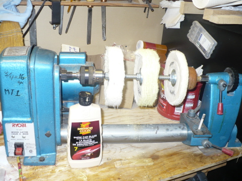

I have a system that I made using an old tube lathe. I think the important thing is using fine grits. I use a Meguires car glaze as a final buff. It gives that mile-deep gloss that makes the customers say WOW!
I had done a similar buffing setup as bradh shows in post #21 above, using an old Craftsman tube lathe (tube bed cut down to desired length), and loved it. One advantage was adjusting the RPM as desired. It was a great step forward, eliminating most of the micromesh grits as Curly mentioned, and at the same time gaining great results on the finished product. I highly recommend incorporating buffing, how ever you do it!
