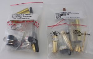

The Timberbits kit "felt" like its components were more solid. That started from the fact that they were packaged in a larger, heavier bag. (I know, nothing to do with what's inside; but that was my impression.) As it turns out, the Timberbits components are actually heavier; totaling 57gm vs the Berea's 49gm.

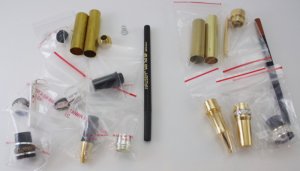

The Berea bag seems to contain many more parts (there is one) but the difference is that some of the Timberbits pieces are already assembled.

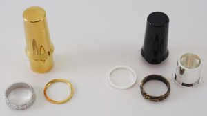

Finial, clip, clip ring, and clip bushing are separate pieces in the Berea kit, and it is a one piece assembly in the Timberbits. Also, I noted that the clip bushing wall thickness in the Timberbits kit is thicker - .039" vs .035". The entire assembly is also heavier than the Berea - 19gm vs 15gm.

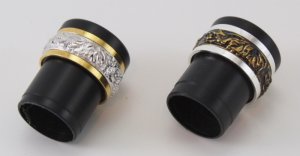

Center bands are similar; again the Timberbits is heavier - 4gm vs 3gm.

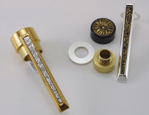

Receiver, receiver holder, and spring were pre-assembled in the Timberbits bag; and were heavier - 15gm vs 13 gm. The Timberbits receiver and holder appear to be one piece, and the spring was already in place.
Nib components for both kits weighed in the same at 11gm. My Berea kit came with a second nib holder; I think it was as a result of some complaints about the black one.

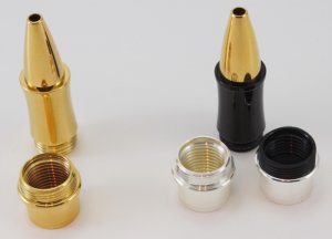

Another difference between the kits is in the tubes. The wall thickness of the Timberbits tubes is about 2 thousandths more than the Berea. This results in the tubes weighing an extra gram as well. The other impact of that difference is that my barrel trimmer for the Cambridge cap would not fit into the Timberbits cap tube. However, the trimmer for the barrel tube did fit in both kits. I didn't actually try this, but I'm going to assume that my Berea bushings wouldn't fit the Timberbits cap tube.

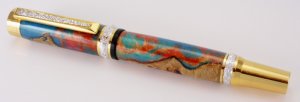

So here's the pen put together. Like I said, I wish that I had properly prepared the blank, but that will be the subject of another thread. Also, I agree that the black band has got to go.
