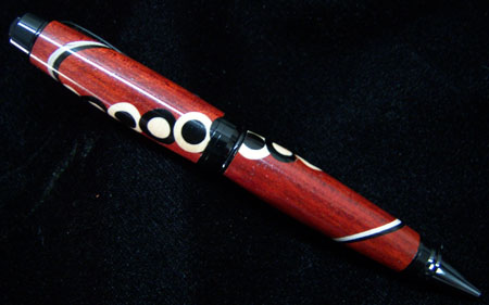

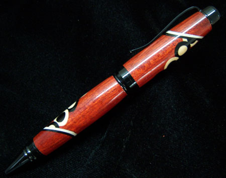

This one is kinda fun. This is Curly Bloodwood, Ebony, Holly and Veneers (There's no metals involved! LOL). The kit is a bright black Cigar Pen. Any and all comments welcome. Thanks for looking.

Man, I am going to have to stop opening any posts by you... I don't know what your tag is for, but my reaction to all these pens is "ack!... how did he do that!"
Beautiful pen. I can't even begin to figure out how long it would take me to do that! The circles would have been impressive enough, then I see the circle in a circle, THEN I notice the overlap so they couldn't have been all drilled then inserted as a batch!
ARGGGG... You must have WAY more patience than I do.
Yep this sucks I hate looking here also I just get depressed that there are so many show offs! :biggrin: Boy I tell you what that is an amazing pen! Please please tell us how you did it!:befuddled::confused:
Thank you all so much for your very kind words. It really means alot to me coming from all of you. I feel that all of you possess great talent and I am proud to be able to show my work along side of yours.
This piece is actually just more tedious than it is difficult. First I turn the main body to a cylinder. While still on the lathe, I index it and run a center line the entire blank at each index point. Then, measure and mark where you want your holes on the blank. I have a small drill press that I use, holding the blank in a V-block. Once you figure out the size and placement of the holes, center punch them on the blank. Having picked your drill bits, now you have to turn dowels of your selected material to the size of the bit. Now proceed drilling the blank (only to center or a little less). Then I put glue in the hole, insert the dowel and then cut it off. Just keep doing that until you have what you want.
