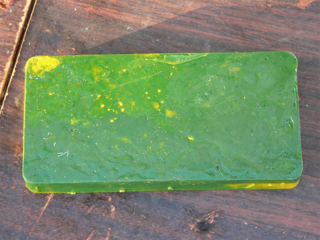

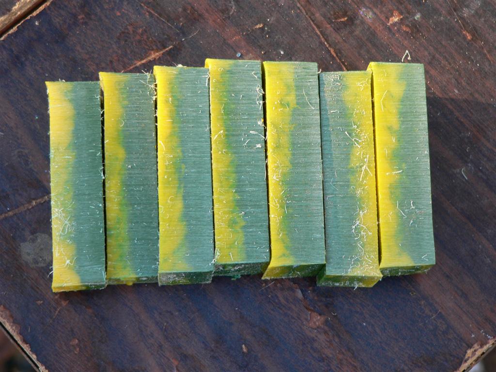

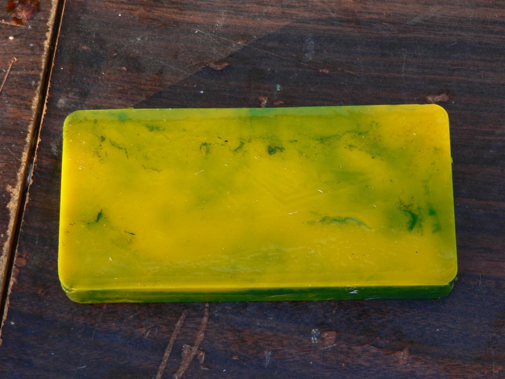

Ok on my second casting attempt I wanted to make a green and yellow swirl blank. My mold holds 8oz so I put 4oz into two cups, in one I mixed my green and in the other I mixed my yellow. Added the MEKP to both cups mixed and then poured them both into the mold at the same time, swirling them around and over each other. After they were in the mold I stirred gently for a few seconds more to help mix then put it in the pot to cure. When I took it out this is what it looked like:
The yellow separated from the green. So, what is the secret to blending colors?

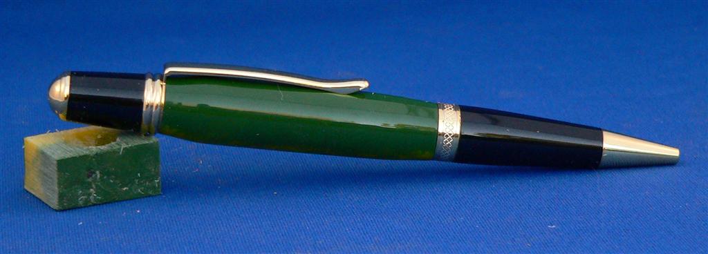

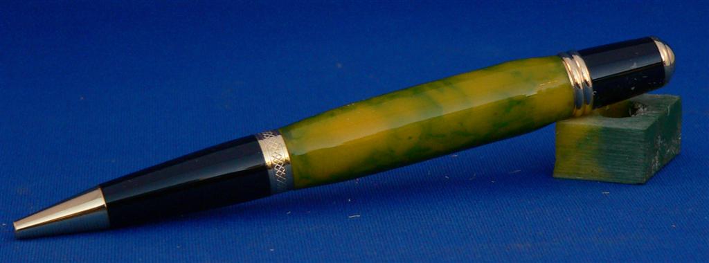

BTW here are a couple pictures of it on a pen.
The first picture is what I was aiming for.

Dale, the trick to good swirls is to make sure that the two different colors are the same consistency. Otherwise you get seperation. Meaning the heavier and thicker of the two will sink.

What Keith said. My first guess was that the pigments were different kinds of materials with one being heavier than the other. Or that you had more of the green pigment mixed in than the yellow making the mix heavier.

Your probably right about having more green. Both pigments are "Hastings opaque color" that I got from the store where I purchased the resin. The colors are a paste and I noticed when I opened them the yellow was drier. I found after I had mixed and poured them that there was a glob of yellow still on my stirrer.
It's too bad they separated like that, the blank was the easiest PR I've turned.
