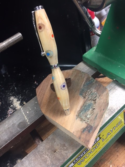

made another colored pencil slimline yesterday. It turned out pretty good. Looks better in person.
Excellent Finish Bobby,
How did you keep the Colours from the Pencils, Spreading or Smearing to the Host Timber during Turning, and Finishing?
Well done.
Brian.
All i can say I did was sind through to 800gt. the used medium CA about 6 coats then the micro mesh. outside of that nothing special. only other thing I remember that might have helped was I used thin CA after I tubed the blacks and coated the pencil spots. that night have helped to soak into the lead to help.
