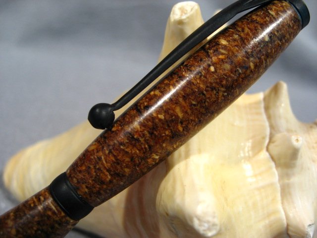

This is one that I turned from a piece I found on a pallet at work. I dont know if it's the same thing or not. Ya'll tell me. This is not dyed, just turned sanded w/mm and finished with ca.
the thought of using mdf is a curious one. try one plain? then try different color stains? the use of a stabilizer is almost a must though.

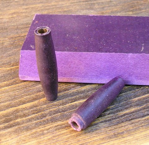

I have turned a purple sample and I must say that it turns smoothly. I compare it to turning COLORPLY. It turns to a very fine powder and the colour penetration is throughout the blank. I sanded to 400 grit and applied a sealer. After this point a did a CA/BLO finish that turned out terribly. After light sanding again, I tried an aerosol lacquer and that also turned out bad. My conclusion at my first and possibly only attempt is to say that this material does not hold a finish well[:(].
Although I planned on making a Euro chrome pen at the end, I've decided not to complete the pen since I'm not happy with the overall results. Will save the chrome hardware and apply it to 'real' wood. The other positive result from this turning saga is that the 'fine' powder residue may be used as embossing powder to accent another project. Will hope that another turner may experience better results than what I ended up with. Let's keep this post going and input your results

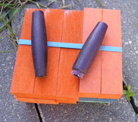

Thought it would be helpful to include a few pics of the MDF sample pen blanks that I cut to size. The finished purple Euro just didn't give me the expected result that I was looking for[:(]
-Peter-[:)]

I have been working on a blue piece and am having results like yours. I drilled it with great caution and had no problems. I started to use thin CA to glue the tubes in but decided on epoxy. I cut the corners off on a belt sander, and turned it to size. I used sanding sealer and the color darkened but I still didn't get rid of the fuzzies. CA was next, several coats, and the color darkened more. I finally got rid of the fuzzies but I doubt if I finish the pen. I can't get an acceptable finish on it. In my opinion this stuff would be good for some flat work but not for pens. I realize my problems with it could be my skill level, others may do better.
