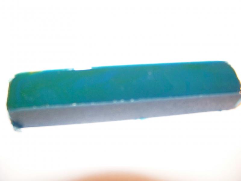

Does anyone have a Turquoise recipe they would not mind sharing? I have been trying to get a nice light bluish greenish but keeps coming up with....... lets just say not what I am looking for. If you have one you would not mind sharing it would be appreciated.
If it matters I am using Alumilite.
Turquoise
Played with this today.
Alumilite Clear
Blue Dye
Green Dye
A little white dye
Tried to swirl a little yellow. Not sure how it will look after turned turquoise.jpg. Probably try Friday

Hey Chris
You must use dyes made for polyurethane.
I only use Alumilite dyes
Now there may be some argument from someone, but, there is a time to be cheap and a time not to. If you use what a manufacturer recomends for the product, then there shouldn't be problems.
When you add white dye to a dark color, it takes a lot to overcome the dark.
Before I added the white(just blue & green) it was a real dark turquoisey look. It took about 16 drops of white to get the color shown.

Well here's my first attempt after getting some Allumilite White Pigment in. I made a white resin and added blue until I got it blue enough then started slowly adding green until I get here. Looks like I could stand to add a little more of each to get a richer color to match the stone I was using, but it's a start.
I'm pretty lazy, so when I want a turquoise-colored blank I just use turquoise-colored pearl ex.
I have that color but it was not what I was looking for. The Blue-Green Duo is closer to what I wanted and will use when I want it w/ swirls but I was looking for a flat color.
