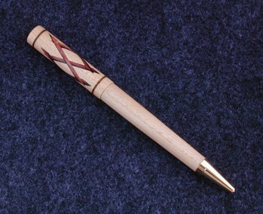

Jack, If you'll turn down to the point where you start sanding ( I use a skew and start sanding at 400 grit.)and "seal" the wood with thin CA You won't get the "bleeding" from the bloodwood. I've turned several diferent glue ups from paduak or bloodwood combined with maple and if I use this method I almost never get the bleed over. Good luck!!! BTW here's a Paduak and Maple glue up I did using thin Ca as a sealer before sanding

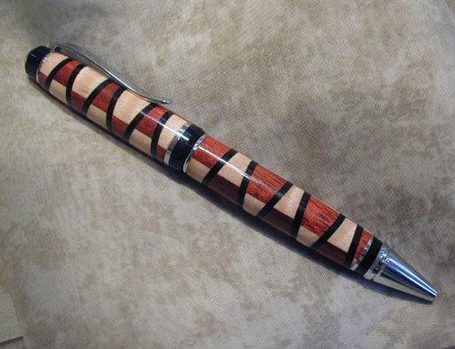

But I have to disagree. Yes Bloodwood and maple can be a problem, Yes Paduak and Maple can be a problem as well. But I would personally have to throw this one in the bag as the two (well actually three) most difficult combinations of wood types.
<b>Ebony / Bloodwood / Maple</b>
