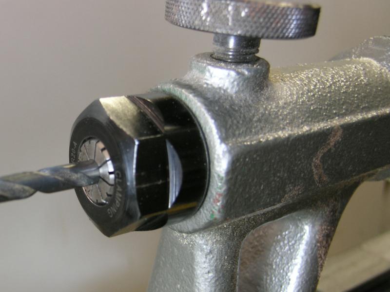

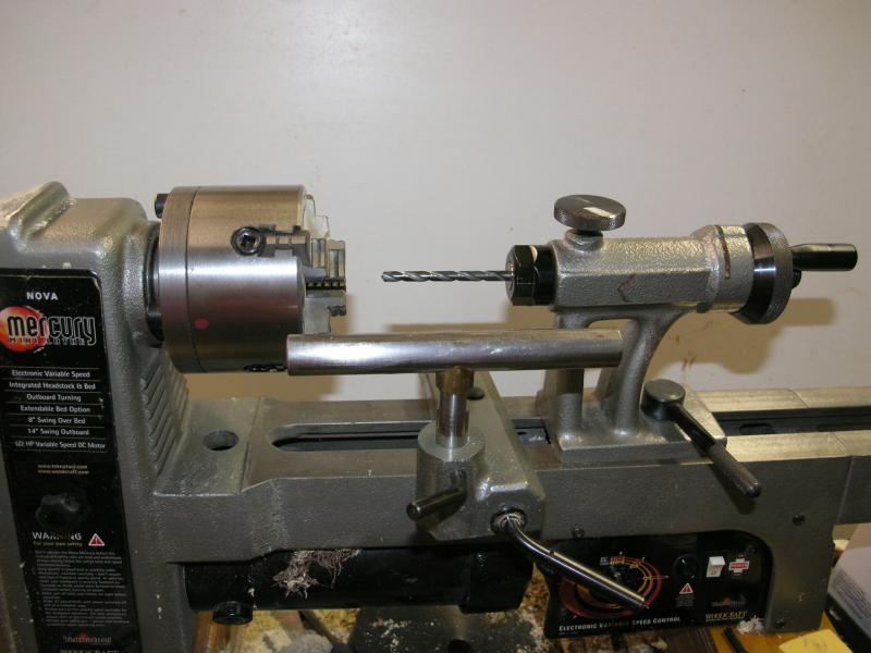

....and applications
1. Provides access to tailstock through hole.
2. Extends effective center to center work area.
3. Provides additional stability at drill bit tip.
4. Variable stick out for tools extending thru tail stock.
Chuckie, Thanks for that picture of the Nova (style at least) Chuck (bottom picture left side for everyone else). it shows just how painful a brush with it could become. Although those jaws are great for holding things where you want them to be. they also make a great grinding machine for anything that gets in there way. I found myself working within an inch of them every time I made a pen and woudl get my skew or gouge to close once in a while. at the very least it made me jump pretty good. compaire to the size of the collet chuck in the tail stock. for holding a mandrel both of these chucks would do the same job. your knuckles would survive an encounter with the collet chuck in much better condition though.
