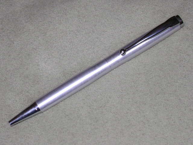

A little light oil worked.Yea!! Used 600 grit sandpaper to give it a cross hatched brushed effect. DSC02112.JPG
