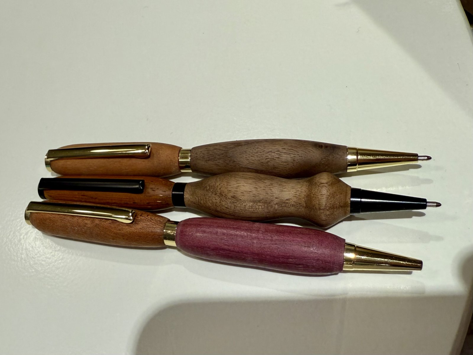

I appreciate all the thoughts posted above! I am just starting out so my focus has been on improving my technique with the slimline pens. I am also looking to sell them as souvenirs made from local wood here in the near future. However, I would like to improve my quality and you have provided some great information for me. Thanks again!
