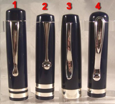

I think the bevel look is nice. I think leaving the ball full at the bottom and possibly rounding over the top similar to the #4 clip below would look nice.
You mentioned shrinkage, are you planning on casting with sterling or using PMC? I didn't think sterling shrank when cast.

This is a case where one test is worth a thousand opinions, but in my opinion, if I'm reading the dimensions correctly, the .127 height is a little too thick. I'm fabricating clips from 14 gauge (.064) sheet or even half round that is about .060 to 0.080 high and that gives plenty of strength. As for the ball, you will only know which you like when you make both.
Bruce, you're reading it right, at the bottom of the grooves though I believe it's only around .07 -.08 , it's also tapering as it goes towards the tip., there it's only .04 just as it goes into the ball end.
