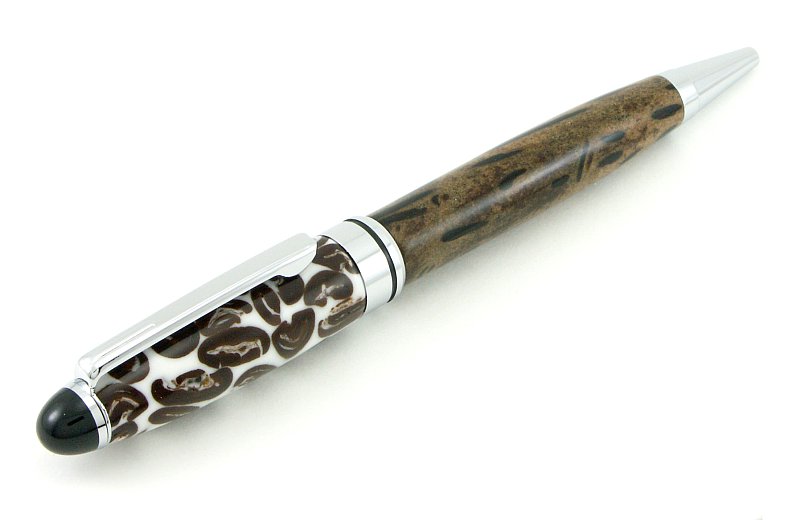

I used a carbide tipped tool (EasyRougher) with a light touch and only had minimal chipout on a few beans that I could easily repair with CA and coffee grounds. I did coat the blank with thin CA when I was getting close to my final size.
