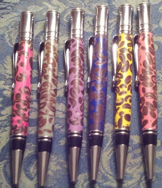

I cast these in Alumilite over the weekend and used a pressure pot. No pre-treating of the beans at all. A little ca as I turned them.
