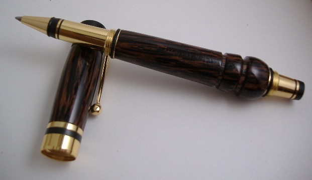

I gave it ago and and this is what I did.... I tired to do some different shapes. the groves sure are hard to smooth the CA in.
