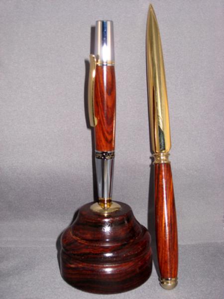

I made this New Years day as a birthday present for my wife. (a New Years baby)
She had asked for a letter opener and I figured why not make it a set.
Trouble is, now I seem to be allergic to cocobolo. I have a rash on the crease of my arms at the elbow, neck, and chest! :eek:
The worst thing is I Love Cocobolo! and I don't like the thought of not being able to work with it! :mad:

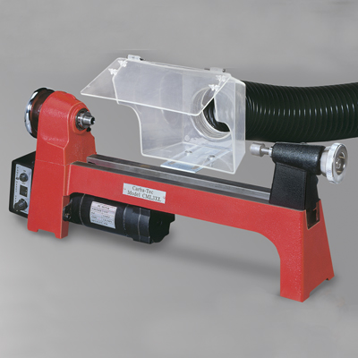

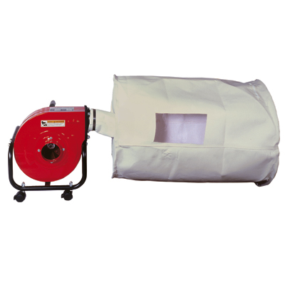

I just bought the portable dust collector from PSI and the magnetic dust hood too. I'm wondering how I got along with out them. The turnings get sucked right up and sanding is such a pleasure now no residual saw dust to speak of other than what gets on my hands while sanding. I have asthma and sometimes the sanding could be a problem so I used a pressurized full face mask from Trend that helped a lot but was cumbersome and constantly needed recharging. I also wear latex disposable gloves sometimes with wood that has bothered me in the past. If your dust collector is not working well I recommend this one I've been very please so far with it.
This is very similar to the dust collector I have with the exception that mine was used and when I ordered a replacement bag from Grizzly the one they sent has an opening of about 18". I called to say they had sent the wrong item and they insisted that it would work (and wouldn't exchange it). By the time I gather up all that cloth in the clamp there is enough excess fabric to effectively make the hole about 1 1/2" I think!:frown:
I do like that magnetic dust hood! That and a better bag might just be the ticket.
