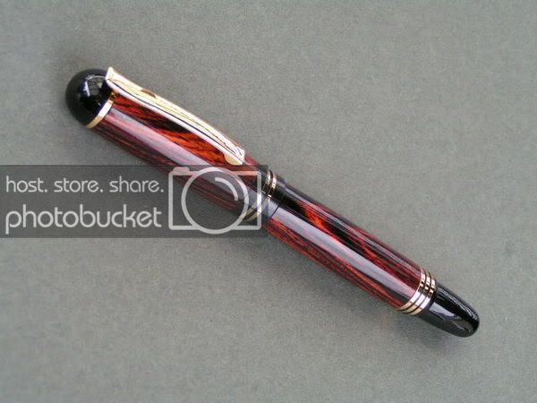

I use CA on Cocobolo, however, Enduro looks good on it too but have yet to try lacquer! This is a CA finish on Cocobolo.
Using CA as a finish on Cocobolo is a darned good way to go. The CA reacts with the oils in the wood and the finish is superb as is displayed by the pen Ligget has posted.
Great job on your pen Mark, excellent finish work. :biggrin:
