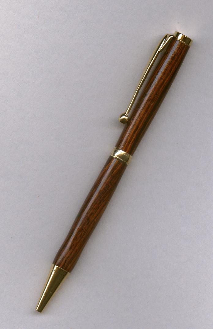

I have only turned about 6 pens so far and have used poly to finish them. It has a nice gloss and finishes well. My problem is I turned apen out of cocobola and the poly wont dry! Have used the same can of fast drying minwax poly on olivewood, dymondwood ,zebrawood, and I think bocote. No problems but after 1 week the cocobola is still tacky. Any sugestions?

Thanks all . I came home after work, sanded the still tacky (after almost 3 weeks now) poly off, polished with steel wool and then applied several coats of ca. Could never get the 2 bumps (comfort grip ha!) to shine like the rest of the pen. Tried jewelers rouge(gave everything but those 2 spots a mirror finish) and finally after about three more tries sanding and ca'ing gave up. Went ahead and polished the whole pen with jewelers rouge and waxed it with mcquires car wax. Critique away, I know i am not pleased but it does look okay. The wife says I notice to much but I wouldn't want to give it some one. Try again another day. Thanks for all the input.

As another poster mentioned, you need to do an Acetone wash before finishing Cocobolo. Wipe the barrels down a couple of times and let them dry for a few minutes, then finish as normal. If you have to wait more than 15 minutes before you can apply your finish, you should rewash the surface with Acetone and start over. Good luck and best wishes! By the way, your pen looks very nice! Take care!
