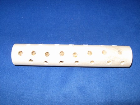

OK, now how bad do I want this? Sounds like a lot of work. I just put mine on a window sill in my work shop. Guess I had better check them, they are probably all twisted. These would have been perfect for pen because they are not very big in diameter. I have a few more to eat, maybe I will get lucky and get one dried about right.
Before you do that, wrap it in a little newspaper and stuff it in a pipe. It'll let it dry straight rather than curling. Wrap it in newspaper to take up any extra space in the pipe. It'll take a little longer, but it's good insurance.
Ok a quick picture of my newly invented "corn cob dehydration chamber". Was going to try to patent it but would be too expensive because of all the hi-tech equipment required to manufacture them in great quanities. Besides, I'd have to pay Skye royalities for the idea!:clown: Now if it doesn't mold...
Heh, looks like it should work just fine! If it's anywhere as hot as it is here, it should dry pretty quickly.
