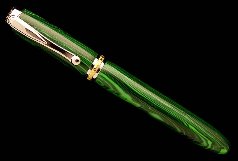

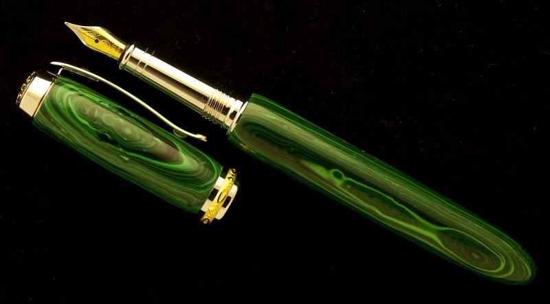

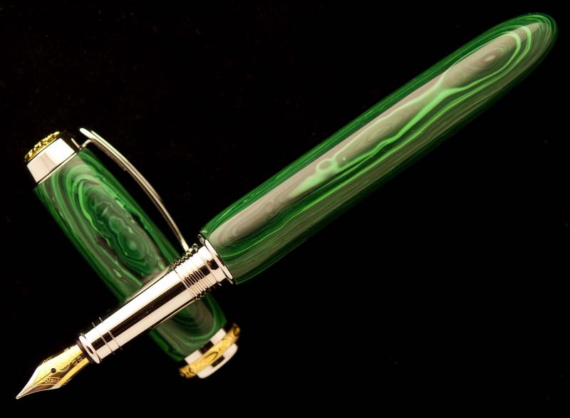

Made it this A.M. It's Malachite Tru-Stone from Exotics on a Jr. Statesman Fountain Pen. I made it a closed ended pen. It's my first closed ended Tru-Stone. The bottom barrel is a little longer than I would have liked. Anyway, I hope you like it. Comments welcome and most of all thank you for looking. Regards, Doc

Very nicely done! I too have made one from Malachite, maybe my all time favorite tru stone!!
I find when I make solid end pens the bodies do get longer so we can safely support the length we need for the refill or pump. I have found that I can shorten the cap as well, this difference can keep the over all pen nearly the same length, but also give the balance the writer wants in the un posted pen body. I have done this for three years and the results are better than I expected.
Absolutely beautiful. I would buy that !! Green is one fo my favorites and I love Malachite (especially with a grandson named Malachi) My new goal it to make a pen like that. It will be a while, but one day I will do it.
Wizard, that's a mighty fine looking pen. I need to get some of that malachite trustone.
