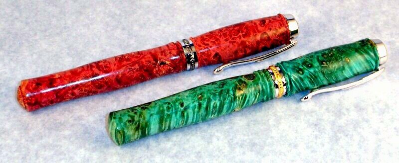

These Jr. Gent II's are made with dyed and stabilized box elder burl (yes...more wood from the plastics guy), using Arizona Silhouette's new closed-end mandrel. Hope you like them.
AWESOME PENS!!!
Only now you're learning that wood is good? [:D][}:)]
Okay, I am only learnig now that acrylics are good too (so we are on the same boat) [B)]

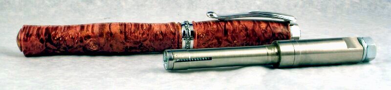

Dan, I'm completely sold on it. The main feature is when the nuts are tightened, the mandrel expands uniformly, locking the blank in place, perfectly centered relative to the brass tube.
I have that mandrel, I did not know it fit the VII of the Jr's...nice to know!!
Ed, they came out real nice. I should be receiving mine tomorrow.
Jim, if you have that mandrel you probably have the one for the Baron pens and it won't work for the Jr. Gents and Statesmens.
That particular mandrel for the Jr's just showed up on Arizona Silhouette's site just last week. [:)]
Ed,
Those are REALLY sharp! Did you add the CB from a different kit, or am I just seeing a reflection in the colored portion of the CB?
