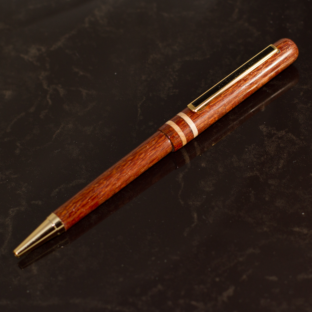

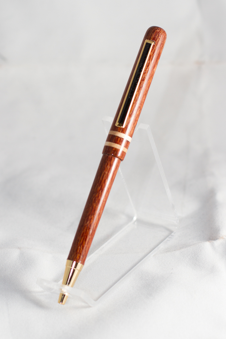

We all see the flaws in our own work. Great looking pen!!
Excellent Pen, Geoff,
Love the Closed End Modification, and the fact that you made your own Pin Chuck.
Could you please tell us what you did to attach the Clip?
Excellent Blank, Fit and Finish.
Great Work,
Brian.
Sure thing, it'd be pretty hypocritical of me to say how useful this site was for info and then not share details.
While the upper barrel was still in the pin chuck on the lathe (but not turning) I used a Dremel knock-off with the smallest cutting head I have to make a recess. Then I trimmed most of the ring off of the clip and almost filled the recess with medium CA. I stuck the clip in the hole, gave it a shot of activator to secure it a little and then let the glue cure overnight. At first the clip was pretty flexible, but after the CA cured is pretty solid.
I think next time I try a recessed clip, I'll drill the blank deeper so that I can keep more of the ring on the clip and just reshape it to fit in a small hole. I'm not sure how well this one will hold up long-term.
