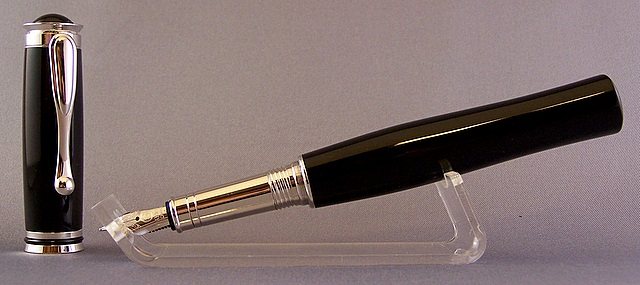

Here's a closed end Retro I finished several days ago.
<br />
