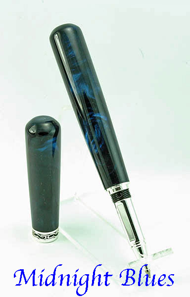

I use the closed end mandrels from Arizona Silhouette and swear by them. A little spendy but if taken care of they should last forever.
