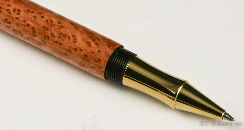

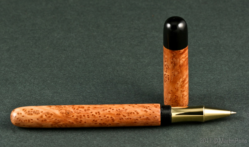

This is a new concept I am working on in an effort to eliminate the black ring used on the churchill nib coupler.
I have a tutorial for this. I will post the link to the tutorial once it is placed in the library by the powers-to-be.
I am not completely happy with the end product. However, it is a step in the right direction and is a fairly economical solution if the Statesman kit is used with Churchill tubes. (see tutorial for explanation)
Martin

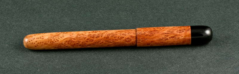

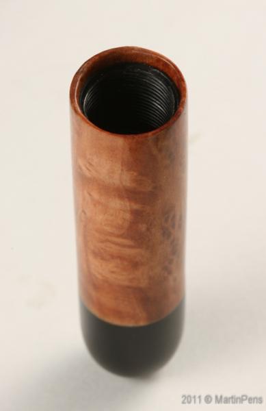

Wood info and a couple more photos
The wood is a Lace Burl Redwood. I'm including a couple more photos for detail. The tutorial is detailed with lots of photos. Still waiting for instructions on submitting the tutorial.
The shape of the pen isn't "on" yet. It is a work in progress.
Martin -
Nice job on the pen! Can you tell us how thick the wood rim is at the end of the cap? Also, do you feel that at that thickness it will not break under normal use? I did a very similar thing but the end of the cap was much thicker.
Thanks,
hebertjo said:
Martin -
Thanks,
It is .98mm
It seems very solid to me. The Redwood lace Burl soaked up the thin CA when I applied it inside and out. I don't have any concerns about it breaking.
The cap diameter is 15.58mm and the body diameter is 13.67mm
I will likely use this design for the look-alike cigar pens I make.
Martin
hebertjo said:
Thanks Martin!
Good to know that at 1mm it is still study. You have given me confidence to turn thinner!
It can depend on the type of wood too. The inside area of the cap unsupported by the nib coupler is only 2mm. Would it crack if I dropped it on the tile floor? It might.
