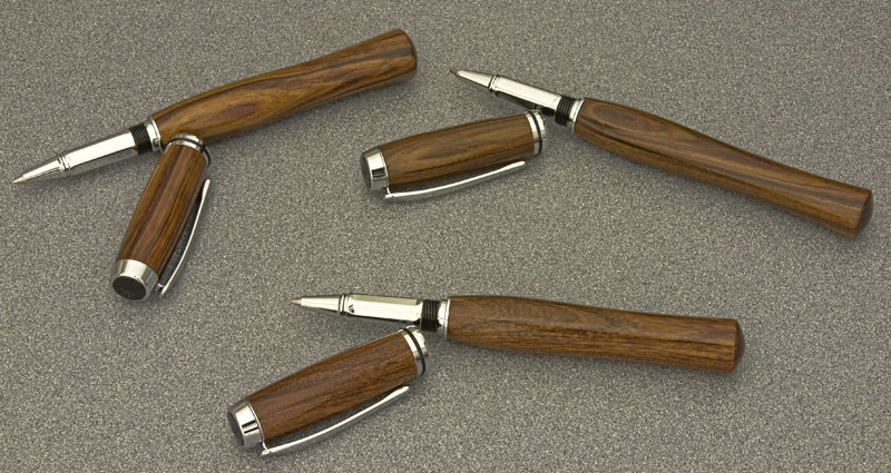

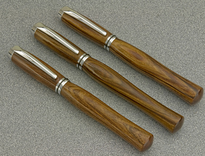

My first attempt at a closed end pen was a complete failure. It looked great, until you tried to put the refill in. Looks like I hadn't properly measured for drilling the hole deep enough. So a quick chat with Steve (pensbydesign) and a new set of measurements, and I gave it a shot at making 3 closed end pens to thank a small group of co-workers for a recent kindness... Chrome Navigators, Woodcraft Grab Bag Mystery Wood (from the smell, I'd guess Tamboti) I really like the closed end idea, and I'm looking forward to trying some new designs, but for now I kept it simple and ripped off one Steve had shown me...

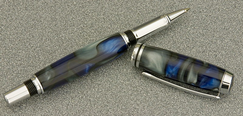

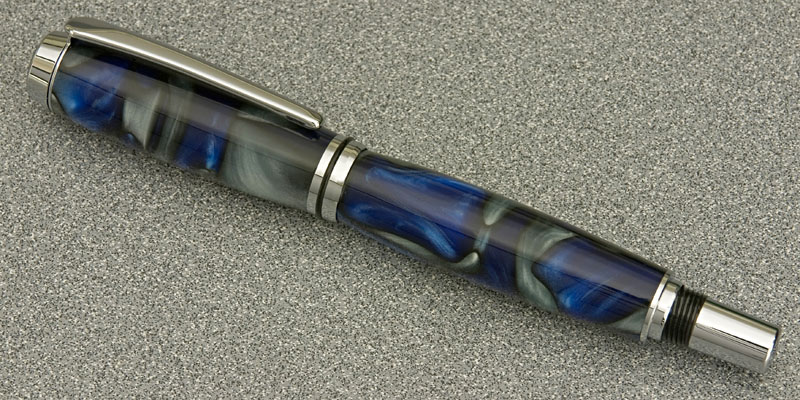

And a standard chrome Navigator in some Woodcraft Blue & White Swirl Acrylic (forget the name) for a friend of my son's (he picked out the style and blank...)
Great pens and I love the background for the photos too.
Also, the forms of the closed-end pens are excellent in my opinion.
