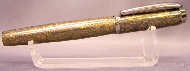

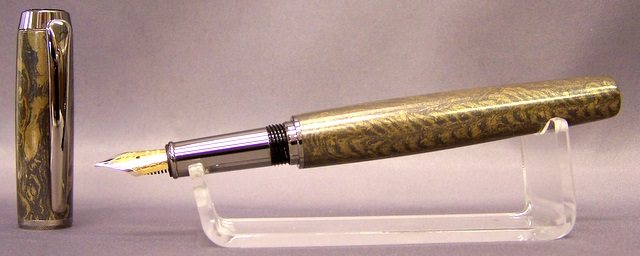

With some of the M3 Metal blanks being shown lately I thought I'd try a closed end version as I haven't seen one done yet. This one is the black and gold version on a Black Ti Baron fountain pen kit. I bought several of the black and gold and have some of the damascus blanks on the way but I'm still not quite sold on them 100% yet. Maybe after I do a few more they'll grow on me.
Thanks for taking the time to look and any comments are very much appreciated.

Great pen! So why are you not sold on the yet, hard to work?
No actually it's very easy to work with but the patterns and random swirling of colors aren't real vibrant, at least with the black and gold. I haven't tried the other patterns yet.
Hi Lance,
I was hoping some one would make one in a solid end, I am glad you did, I always enjoy seeing your work.
I like the pen, it's a classic shape, the material is still growing on me, not sure myself...I would love to see one in the Damascus Look....and by the way, your picture is the best one I have seen yet of this material.

Hi Jim, I appreciate your and everyone else's comments. I wish I'd have set up my light tent and taken a better picture but I had just a little too much of a mess around me to take it out.
I received four more of the damascus blankd today and will order some of the polish that they recommend for a high gloss look. I used micro mesh and brasso then a couple of coats of CA which gave it a higher gloss than just polishing.

John, I dry sanded the blanks. I ordered the 5" blanks at the time and I had to use 2 blanks to make the closed end pen. Now they offer them in 6" sizes so one blank will make a complete closed end pen. I have enough from the second blank to be able to make a Sierra out of it though.

Thanks Lance,
I was wondering about the "look" of the finish and if indeed a top coat was needed. Can you comment on the weight of this pen vs other CE Barons you have made in acrylic or wood please...Thanks again!;)

Lance,
Wow, what a pen!
One thing that can cause the colors to be less vibrant is sanding down to 12,000 grit. This creates such a smooth surface that there is not much light refraction on the metal surface. Try sanding down to 800 grit then brighten with 0000 steel wool. You mentioned that you ordered the Nuvite; that is going to give you the "POP" and the shine that you are looking for. CA can also dull and darken the colors while at the same time adding shine.
I will post this M3 finishing information on the appropriate section of the forum so that others can take advantage of it as well.
Great work,
Mike

Jim, unfortunately I don't have any other CE Barons to compare it to. I did weigh it and it weighed in at 42 grams capped and 22 grams uncapped. I weighed my Jr Statesman CE pen made with Pipemakers Lucite. It weighed in at 44 grams capped and 24 grams uncapped. The shape on the Jr Statesman is different than the Baron though. A little larger around and a quarter of an inch longer.
I know it would be heavier than an acrylic baron but I really like the heft and feel of it. When I get in the Nuvite polish I think I'll take it apart and refinish to compare the difference in glossiness.
