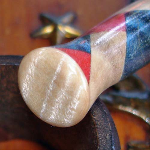

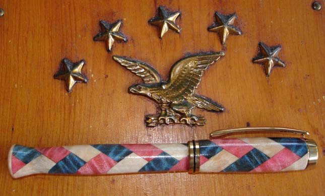

I made this pen today for the day. It's based on Ron Sardo's Laminated tute which can be found in >The Library>Articles 2006>Building Segmented Blanks.
Upclose of closed-end
One more angle

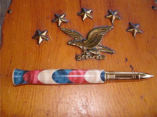

Maybe I should add details of the pen
It was made from three blanks, one each of stablized clear curly maple, red curly maple, and blue curly maple. I had enough left to make one sierra pen. I cut two strips from each blank which were then cut one inch long at a 22.5 degree bevel. This was my first closed-end attempt. I didn't use a special mandrel because I don't have one. LOL. The end cap of clear curly maple was added originally as an extender point to part off, but I liked the look of it, so I kept it.
The screw cap of the JrGent was pressed into the brass tube without the ring. This was glued inside the blank. The cap blank was drilled and glued as normal. I mounted the cap blank with bushings and then the the lower closed end blank on a standard mandrel. Hope that makes sense.

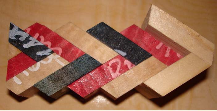

Chuck,
This might give you a better idea. I don't have any pics of the blank, but this is the piece I had left over. It's just long enough to make a sierra. All that I need to do is clean up the edges a bit.
