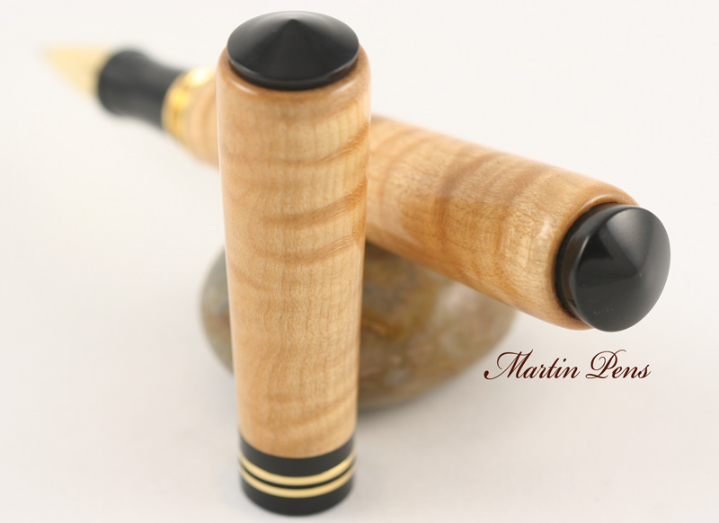

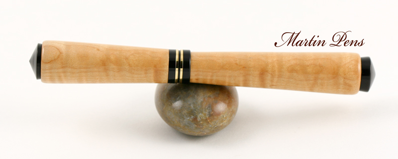

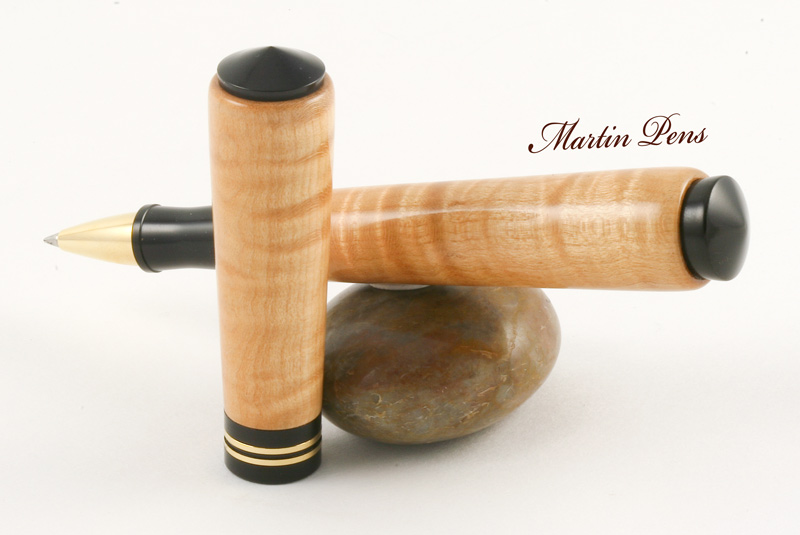

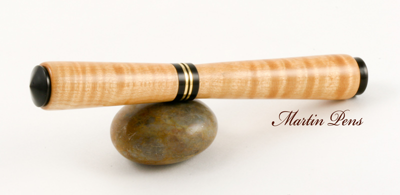

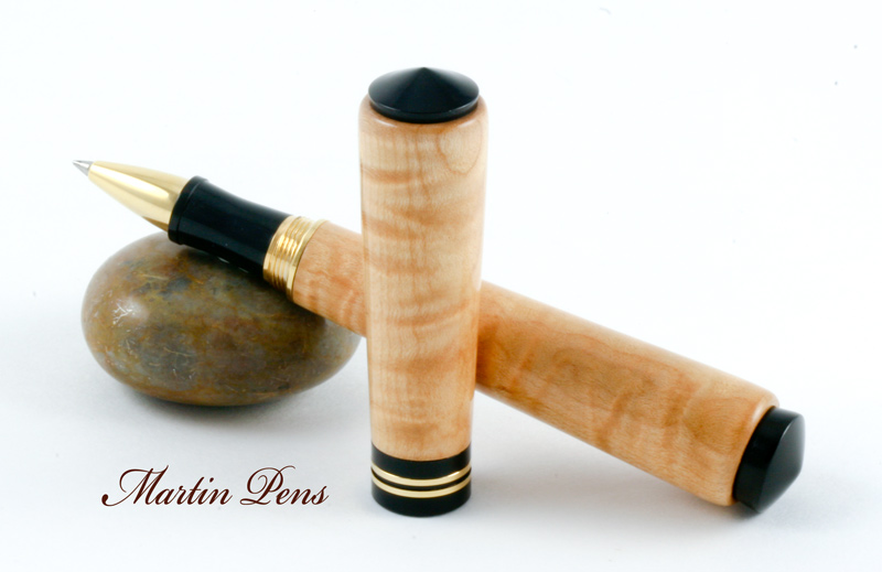

Really enjoying the closed-end mandrels I got from Arizona Silhouette. This pen is closed, but I decided to put the African Blackwood caps on as an afterthought and I really like it.
Would be interested in your input.
Also - ?? I usually use CA when using a regular mandrel - but don't have the guts to use CA on this closed-end mandrel. Don't want to goof it up. Who uses the closed-end mandrels AND finishes with CA - and how do you do it.
Thanks, enjoy and happy turning.
Martin

That looks pretty cool....almost like a Panache, but much better:biggrin:
I really like the cap ends but would have prefered both to be the same thickness as the one on the cap. It seems to be a finer or more refined look.
Why are you worried about doing a CA finish when using a CE Mandrel?
Looks really good. I like the finials. If you are worried about the CA just loosen up the mandrel and pull the blank back to where the mandrel gets thinner in the middle. You'll have a little space to work with and you shouldn't get a contact with the mandrel unless you are really slathering on the CA. Again, good looking pen.
I really like the cap ends but would have preferred both to be the same thickness as the one on the cap. It seems to be a finer or more refined look.
I think I agree skiprat. I did the body cap-end first and then when I made the cap cap-end and retrofit it I saw that I liked it better as thin. But, I also have to say that as I looked at it - it grew on me. And... the potential of screwing up the pen to make the adjustment wasn't worth it.
I'm a "It is as it is" type guy. I really like it when people leave constructive criticism. I was in the graphic design and photography field for a long time and learned a lot from what others observed / experienced. Thanks for putting words to it.
The next one might have matching caps! : )
Martin

It is a very nice pen I love the contrast, it does remind me of the Panache like Skiprat said but I am not a fan of the Panache, This pen I love
I really like the pen. I'm with the others on matching the end caps, but I understand your reservation about going back on it... Sometimes the enemy of good is better. Thanks for the inspiration.
Nicely done, very well contrast. I agree with rat about the caps but You are right I have watched some other pros turning and sometimes just litlle too much pressure or a slight eagerness wouls screw up your otherwise beautiful work. but then again thinking positively when you have to sell it, you can always say that it is unique in the way that it can be easily spotted should someone get their sticky fingers on it.
What a beautiful idea for a pen. I love the wood's contrast. And your finish looks fine. I agree with Skip about the thickness.
Beautiful pen Martin. I love the shapes, the finials, everything about it and in this particular circumstance, I think the more Satin finish makes the pen look warmer and more inviting. Congrats on the front page too!
As has been mentioned, you can slide a pen out more on a mandrel for applying CA at slow speed. I recommend you apply a single layer of tape on the mandrel before you use CA as a finish...just as a safety precaution and at the same time a layer of tape will strengthen the grip of the mandrel in the tube.
Thanks everyone. It's exciting to see it on the front page! I'm making another right now out of curly koa - light wood for the body - dark fiddleback for the caps. Going to get those caps the same size this time and maybe work in a clip. Thanks for all the comments. I love making pens!!!
Martin
