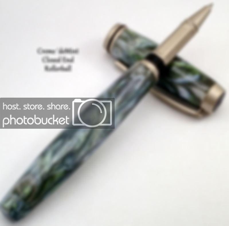

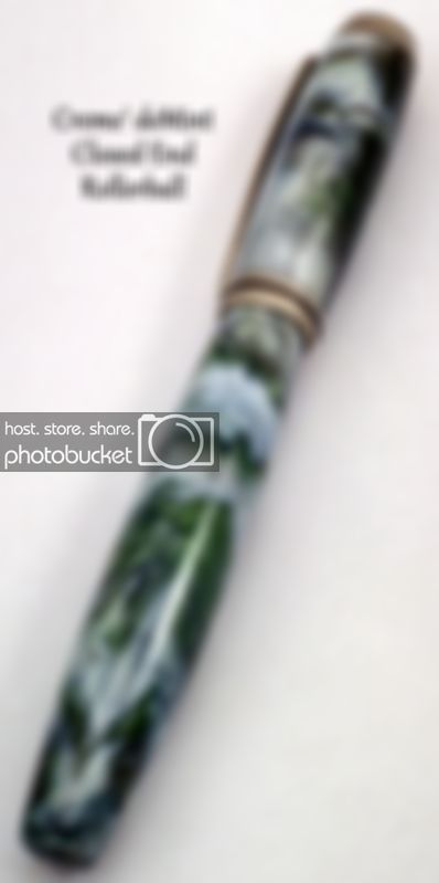

After getting some ERC xcut blanks cut, I decided to get into the 'tuit listing' that the one-that-must-be-obeyed has had laying around for me.
Grabbed a set of tubes and rattle-canned them to the color of white(just to be different, been shooting everything black and needed a changed).
Set them in front of the heater to get them cured and went about drilling some holes.
Happened to have a few Baron Brushed Satin rollerball kits laying around.....so guess what? Yup, closed end rollerball! Used a Creme 'deMint blank(and now I'm wondering if I might do another exactly like this but with black tubes to see what the difference is....hmmm?) No flare on the end today, just wasn't meant to be, had a oops happened and had to fix(got lucky there was enough material to 'fix' it).

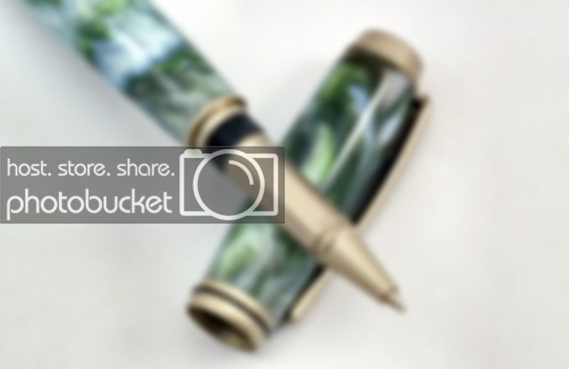

Close-up

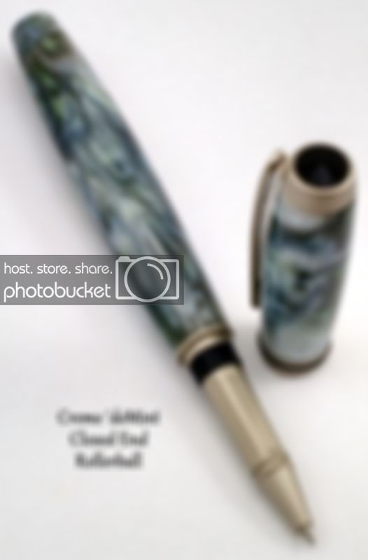

My standard finishing for PR was used here as well. Skewed, wet-sanded to 12K using the pretty pads, PlastixPolished and wiped with a dryer sheet(thanks for the tip to get those fuzzies off).
Thanks for looking! C&C always welcome...
