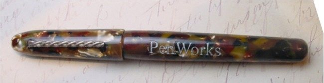

This is a photo of my working prototype, I CA'd the clip in, it eventually worked loose, not to a point coming unatached but a little loose, this was also a proto of my friction fit cap, that eventually, the resin cracked right at the front section of the pen. For all the pen's faults, I use it and is still a good looking writer, has a white gold Lamy nib.
