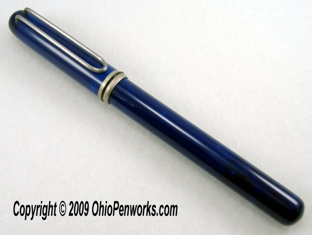

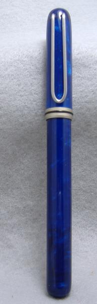

Would something like this work?
clip
Mike, that's a great idea. Surely that's not so simple as being a paper clip? You got me actually thinking now. There's a novelty. Thanks,,,, Russ
I wish I could claim it as my idea. I saw this clip on some of Skiprat's pens and also on ldb2000's work. No, not a paper clip. Care to guess again?

Thanks everyone. Mike, I am curious what that clip is made of. I like the style and would like to try it. Todd is sending me some from another type. Thanks again.

Russ,
Barney already told you. It is indeed, stainless steel welding rod. My example is 1/16 inch diameter. When you buy it the rod will be coated. Use pliers to pinch and crumble the coating off the rod. Then It is just a matter of cutting and bending. If you take a look in Skiprat's and ldb2000's photo albums you will see some other examples of this clip. I glued my clip in. Butch (ldb2000) suggested that by bending the prongs inward the clip can be held in by it's own tension. That way, if the clip is ever bent it can be easily replaced.
