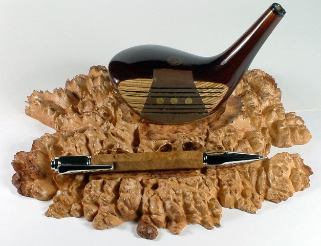

This is my daily carry "Big Click"...
made of Honduran Rosewood Burl. Bought the blank here and the kit from CSUSA.
