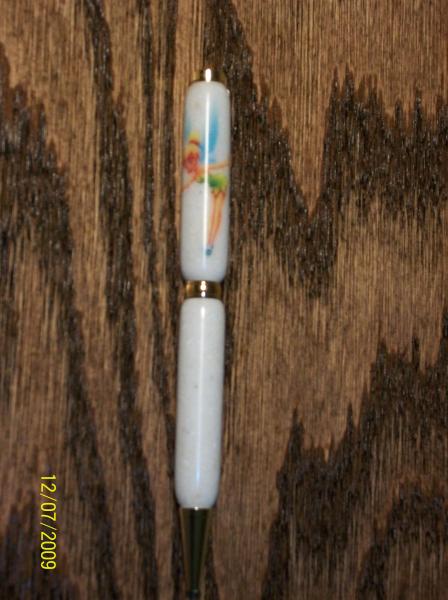

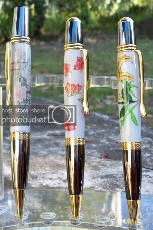

These are my wifes "girly pens" what is it with women and roses lol. She did the printing, application and casting ,and I did the fun bit (turning & Polishing) she has done some in glitter and stickons as well ,but these are the first "Decals" I see lots of possabilities with these ,names ,logos,themes etc .again as with the metals I did, no dramas easy enough for anyone to have a go at ,cheers ~ John

This is what I used here the instructions are very good and worked first time . I painted the tubes with a spray etch coat,then a coat or two of white spray acrylic. I figured as it was being cast in clear acrylic that would give the best chance of success :) . After the water slide picture is slid onto the tubes allowed to dry ,not long as our temperatures are mostly in the 30's centigrade , then the tubes are placed in a resin saver mold ,similar to the ones sold by "Newlondon" pour the mixed clear resin ,vibrate out for a few minutes on my "vibrating linisher table " hehe, then wait ,they set here in a couple of hours but I remove next day ,turn and polish as for any acrylic ,and all done :) My wife did the pictures in Publisher and printed with a standard inkjet printer ,followed instructions as above and it all worked fine , I have read elswhere about label casting and some problems with edges lifting and so on , didn't have any of that doing it this way . hope that helps a bit . Cheers ~ John

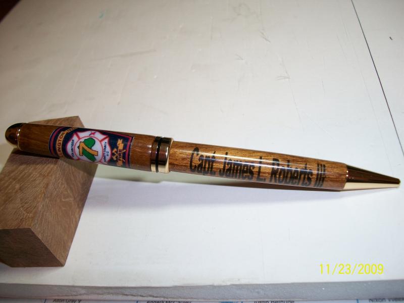

I do decals and the CA has no affect on them as long as they are dry. Havent tried to cast any yet but they do look great. Its on my to do list.......
