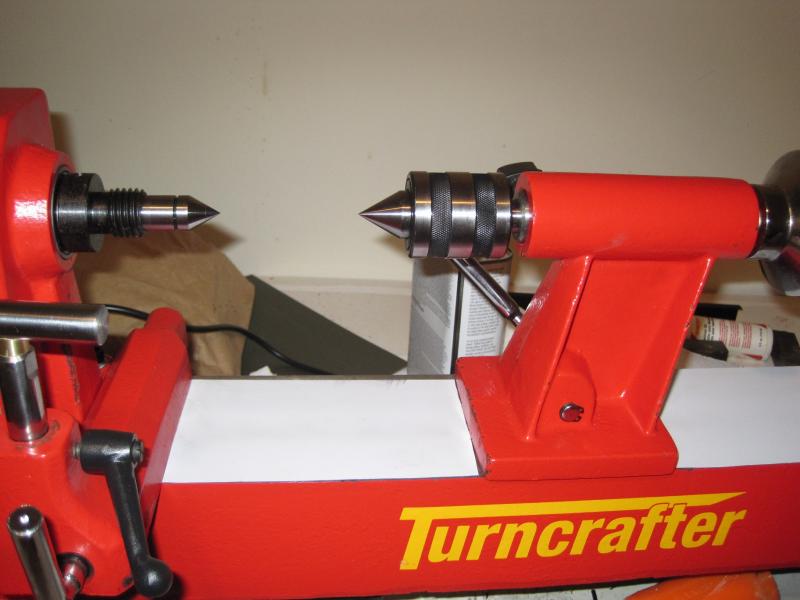

What I did was set up my lathe how I normally sand and finish. Banjo all the way to the left. I then cut the pieces to fit and they work great! Here is a picture with them on.

Just don't leave them on permanently. I had read the same idea for protecting the blades on my handplanes when stored using fridge magnets, looks like the same material. I came back a month or so later and found rust under the fridge magnet card. I don't know whether it is a dissamilar metals thing or moisture is creeping in and causing the rust. Needless to say I don't use them any more.
I just use a piece of cardboard cut to size and lay a couple pieces of papertowel on top of that.
They are only there for finishing. Otherwise I stick them to the front of the lathe.

I coat my ways with Boeshield T-9 and have no problem with rust.
Does the inevitable CA drop stick to the ways though with th e T-9 treatment? I've found it to be very annoying to try and slide my banjo over CA and not get very far due to the buildup.
I used T-9 on my tablesaw and wasn't very impressed with it. Johnson's past wax works much better and the wood slides much better IMHO.
Has to be the cleanest lathe i have ever seen.I use mine as atool and tool's do get dirty,i do clean now and then.Paste wax on the ways keep's the ca removeable.

I usually lay an old t-shirt over the bed when I do CA finishes but I like this just for keeping some of the sawdust out of the crevices and off the motor!
I just use a tool box shelf liner. It is water proof, and says it "eliminates rust".
It is kind of a heavy closed foam sheet. Not a drop of CA on the ways.
