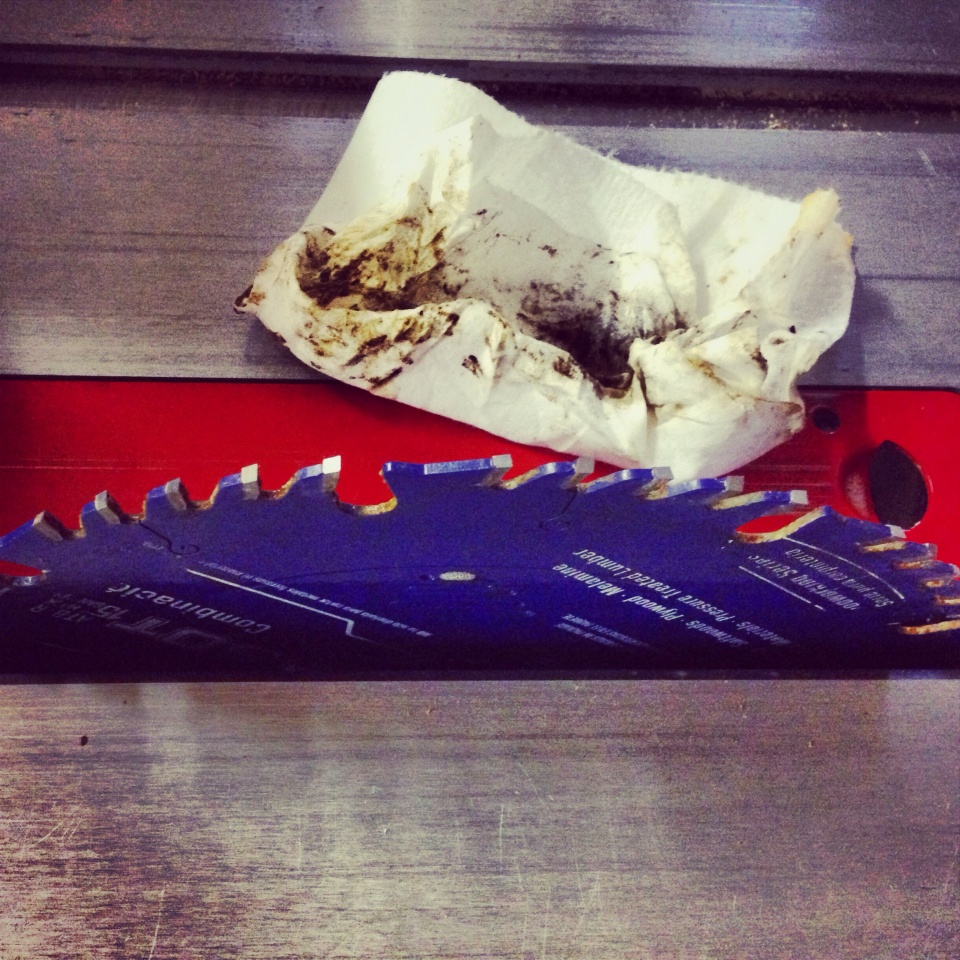

Pitch cleaner works wonders. I sprayed some into my TS blade, let it sit a few minutes and it literally just wiped right off.
