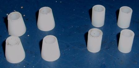

Rather than continuing to have the problem, turn some teflon bushes the CA will not stick to and can be easily cleaned, they also avoid reactions with polishes. I make mine from cutting boards, cones to hold the various larger kits, the sleeves for the standard kits. I also have different coloured bushes for each mandrel.
