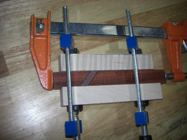

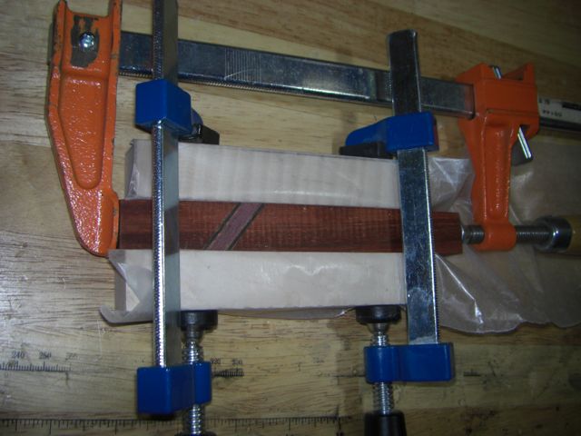

My method: Lay down a piece of wax paper; lay your segmented pen on it; lay two slightly shorter but wider blocks on either side of your blank under the wax paper; use a couple of c-clamps to lightly but snugly press those blocks against your blank (trapping the wax paper between them and the blank); now use a long clamp to squeeze the ends of your blank for glue up. I then remove the long clamp and slightly loosen the c-clamps to slide the blank out or segments in. Very quick, very easy.

Would you happen to have a picture of this?
I didn't, but I do now.
First with no wax paper for clarity.
Then with wax paper.
GK
