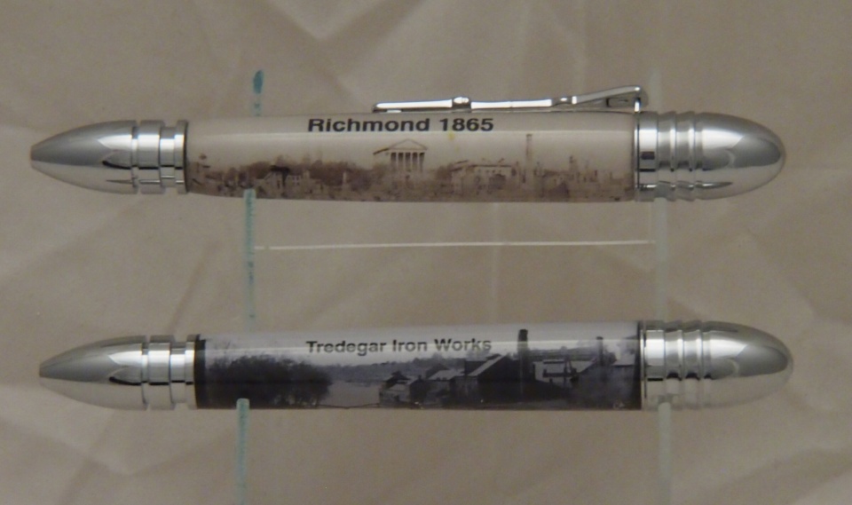

Cwalker935 Member Joined May 18, 2014 Messages 3,525 Location Richmond, Va Jul 7, 2014 #1 Two more Civil War Pens: Richmond after the great fire Tredegar Iron Works

Fatdawg Member Joined Jan 28, 2011 Messages 239 Location Bedford, PA 15522 Jul 7, 2014 #4 Well played! Is the blank a label casting? Last edited: Jul 7, 2014
Cwalker935 Member Joined May 18, 2014 Messages 3,525 Location Richmond, Va Jul 7, 2014 #5 Yes it is a label casting.

plano_harry Member Joined Jan 12, 2012 Messages 1,958 Location Plano, TX 75093 Jul 7, 2014 #7 Nice work Cody. How did you deal with the seam?
Cwalker935 Member Joined May 18, 2014 Messages 3,525 Location Richmond, Va Jul 7, 2014 #8 I used Don Ward 's technique of putting a border on the image, sizing it so that the border overlaps, coloring the cut edge with a sharpie so that the white of the cut edge does not show. Here is one of the images that I used.

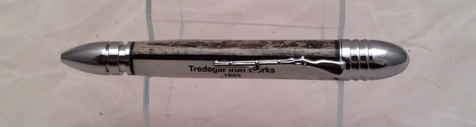

W William Menard Member Joined Aug 21, 2013 Messages 317 Location Lafayette, Louisiana Jul 7, 2014 #9 so on the back side of the pen is a black line representing the frame and the seem is hidden with the black on black ?
Cwalker935 Member Joined May 18, 2014 Messages 3,525 Location Richmond, Va Jul 7, 2014 #10 That's right.

W William Menard Member Joined Aug 21, 2013 Messages 317 Location Lafayette, Louisiana Jul 7, 2014 #12 would you mind posting a pic of the line in the back please
Cwalker935 Member Joined May 18, 2014 Messages 3,525 Location Richmond, Va Jul 8, 2014 #13 Quick picture using ipad, not he clearest.
