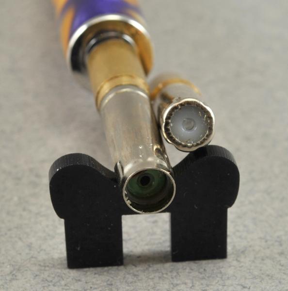

I had some time this afternoon to look into this problem a little more.
The problem was the transmission itself. I took the pen apart to check the transmission (which worked fine) and got another from stock for comparison.
I thought there might be a length issue somewhere.
When I compared the two, the problem was very evident.:biggrin:
The one I installed (upper right) had a problem with the end of the mechanism. I had not noticed this at all when I first installed it. Only after the comparison did I see the difference. Factory defect on the end was the culprit.:eek:

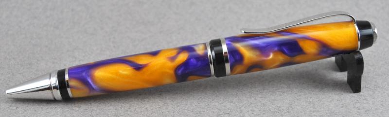

After a new transmission was installed, the finished pen. Works fine.
