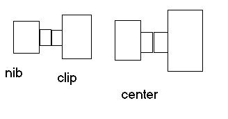

That's right. Starting from the nib end (longer tube) on the left, the smallest bushing goes on the left and the second smallest on the far right (clip end). Then in the center the 2 larger bushings step from smaller to largest on the right. Like this crude drawing.
<br />
Hope this helps.

Are my eyes going bad.....or does the written description not match up with the drawing in Darrel's post???? It looks like the second smallest bushing is labeled as being center rather than clip as called for in the written comment.
No, your eyes are OK. The drawing isn't in the proper proportion. The 2 smallest bushings go on the ends, left and right, stepping up in size as you go to the right. The 2 largest bushings go in the center, stepping up in size the same way. (Nib on the left for these bushing placements.)

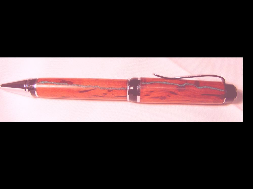

Thanks John and all of you who answer to my question I realy apreciated for the pen here's the photo of the butchered pen with my first turquoise inlay . The wood is Hairy Oak.
<br />
Thanks for your comments
Serge

Thanks John it was funny to drill the groove in the barrel, I use a German mini drill very good and less 1/2 price of the dremel the beauty is that all the dremel tools fit the German drill, my initial idee was to do a strait line ( look like I did have a few bottles [:D] ) will try again the inlay process this week end after the Wedding pen
Serge
